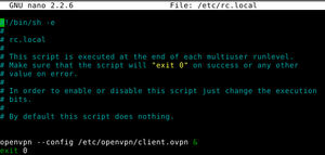

Hi, I have a problem with autologin OPENVPN on RN102 boot. I will describe what I have already done, and plese check what is wrong or what I omitted. 1. I have prepared VPS and open VPN server on p...
