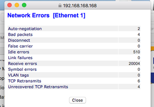

Thanks Stephen,
I've located said log, and it looks like there are afew errors
RX packets.... 4 errors?
Ian
- Ianbpro3Mar 06, 2022Aspirant
- SandsharkMar 06, 2022Sensei
It appears you have jumbo frames enabled. If you do and something on the network doesn't support them (or the packet length specified), it can cause a lot of issues. Have you tried disabling them?
- Ianbpro3Mar 06, 2022AspirantHi, thanks for the reply, I actually enabled it to see if it sped things up abit, but no :(
I’m going to buy a new cable and see how that goes
- StephenBMar 07, 2022Guru - Experienced User
Yes, over 100M received packets. Those aren't enough errors to explain a major slowdown. The bulk of the network errors were reported on the PC, and those are on the PC RX (so the NAS TX).
If jumbo frames aren't helping, then you should turn them off.
Have you looked for disk errors in system.log and kernel.log?

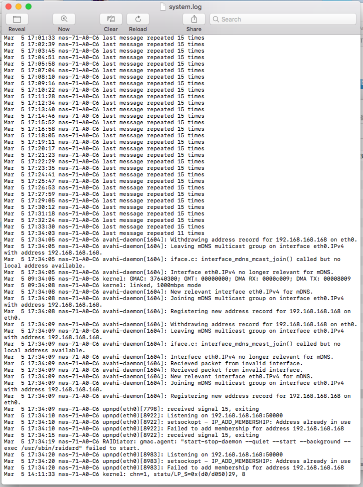

- Ianbpro3Mar 15, 2022Aspirant
Thankyou. I've had a look at the logs, and took a screenshot of the last ones, there looks like there could be something going on
- StephenBMar 15, 2022Guru - Experienced User
upnp isn't going to work with your ethernet connection setup.
I don't think those errors will cause a network slowdown. But you could turn off the upnp and bonjour services in Frontview (Services->Discovery Services) and see.
