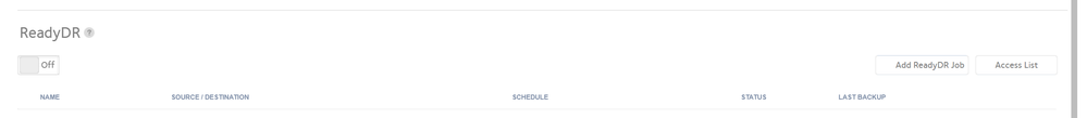

Hi,
i have a RN3138 with 4 drives istalled, the firmware is: 6.10.1. On the admin page under backup there is no option to activate readyDR? I thought this option was there before, but now it is gone. I can only use "file backup".
AFAIK the RN3138 supports readyDR, so how can I reactivate it?
Frank
Odd, it is showing up on my RN526x at the bottom of the page. There's an on-off switch right below the ReadyDR section. Though I am actually running 6.10.2 (which is released).
I suggest clearing your browser cache first (or trying a different browser). If that doesn't sort it, then you could try upgrading to 6.10.2. https://kb.netgear.com/000061280/ReadyNAS-OS-6-Software-Version-6-10-2

- fn34567Aspirant
thanks it worked. It really was just using a different browser!
