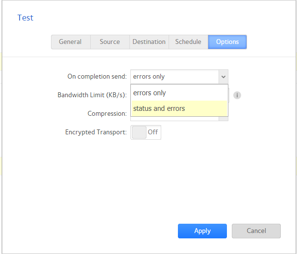

I have several ReadyDR and non-ReadyDR backup jobs set up on my RN314. They are all set up to send me the status, by email, on completion. All jobs are set up to copy files/snapshots (as the case may be) between two ReadyNAS devices - the source is a RN314 and the destination is a RN424. Both ReadyNAS devices are running OS 6.9.1.
The non-ReadyDR jobs send email with the status on completion regularly and without and problem. The ReadyDR jobs don't send any status email at all.

- Yes. All the ReadyDR jobs are set up to send both error and status on completion.
Thanks.- Marc_VNETGEAR Employee Retired
Were you able to check if you are receiving failed ReadyDR jobs?
