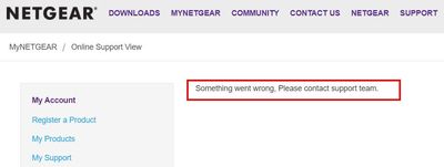

  4. Heck, I can't even look at an old support ticket in NetGear's support portal...upon clicking on it I get this error...seriously!!!
