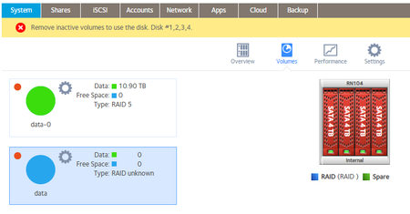

Readynas 104 - Cannot access data - remove inactive volumes to use the disk
Hi, I'm in trouble. My ReadyNAS had a problem with the power plug not connecting fully after moving house. Have fixed it and it is working, but Windows 10 won't read the data. Logged into the NA...

xfixiate wrote:
Each drive shows between 40 and 180 ATA errors - but Ive had this for 10 years.
smart_history.log shows these counts beginning on 21 Dec 2024, though nothing new since 8 Feb 2025.. Worth keeping a close eye on.
xfixiate wrote:
Device date says 7 April even though it is 23 April.
If you click on the settings wheel next to the time in the NAS admin page, is "synchronize time with an internet server" checked?
I am seeing this from last December
[24/12/21 23:40:38 AEDT] notice:volume:LOGMSG_HEALTH_VOLUME Volume data health changed from Redundant to Inactive. [24/12/21 23:42:36 AEDT] err:disk:LOGMSG_ZFS_DISK_STATUS_CHANGED Disk in channel 3 (Internal) changed state from ONLINE to FAILED. [24/12/21 23:46:52 AEDT] err:disk:LOGMSG_ZFS_DISK_STATUS_CHANGED Disk in channel 4 (Internal) changed state from ONLINE to FAILED.
This might be a side effect of your power problem.
I'm not seeing errors on those disks now, but the NAS is choosing not to add them to your RAID array.
[Mon Apr 7 11:22:33 2025] md: md127 stopped. [Mon Apr 7 11:22:33 2025] md: bind<sdd3> [Mon Apr 7 11:22:33 2025] md: bind<sdb3> [Mon Apr 7 11:22:33 2025] md: bind<sda3> [Mon Apr 7 11:22:33 2025] md: bind<sdc3> [Mon Apr 7 11:22:33 2025] md: kicking non-fresh sda3 from array! [Mon Apr 7 11:22:33 2025] md: unbind<sda3> [Mon Apr 7 11:22:33 2025] md: export_rdev(sda3) [Mon Apr 7 11:22:33 2025] md: kicking non-fresh sdb3 from array! [Mon Apr 7 11:22:33 2025] md: unbind<sdb3> [Mon Apr 7 11:22:33 2025] md: export_rdev(sdb3) [Mon Apr 7 11:22:33 2025] md/raid:md127: device sdc3 operational as raid disk 0 [Mon Apr 7 11:22:33 2025] md/raid:md127: device sdd3 operational as raid disk 1 [Mon Apr 7 11:22:33 2025] md/raid:md127: allocated 4294kB [Mon Apr 7 11:22:33 2025] md/raid:md127: not enough operational devices (2/4 failed) [Mon Apr 7 11:22:33 2025] RAID conf printout:
The RAID system puts a transaction count on each disk, and updates that on every write to the disk. The "non-fresh" status means that some writes were missed on these two disks. That could be a result of the issue on 21 December, or it could have happened if the NAS wasn't properly shut down when you were troubleshooing the power problem.
Either way, it is possible to force the array to mount from tech support mode. If you want to pursue that path, let me know and I can give you advice over private message (using the envelope icon in the upper right of the forum page). There could be some damage to some files, since some writes were lost. But it is likely slight.
The other path would is RAID recovery. You'd have to buy some equipment and software to do that yourself, or you'd need to find a recovery service. You could mail them the disks to avoid the travel complexity. This is lower risk, but would cost. (And I do think the risk is slight if you are careful to follow my instructions).

xfixiate
Apr 24, 2025Aspirant
A huge shoutout to Stephen who has helped me get my NAS data back.
LIterally "saved" my life.
I could not be more grateful for his help and for the community here.
