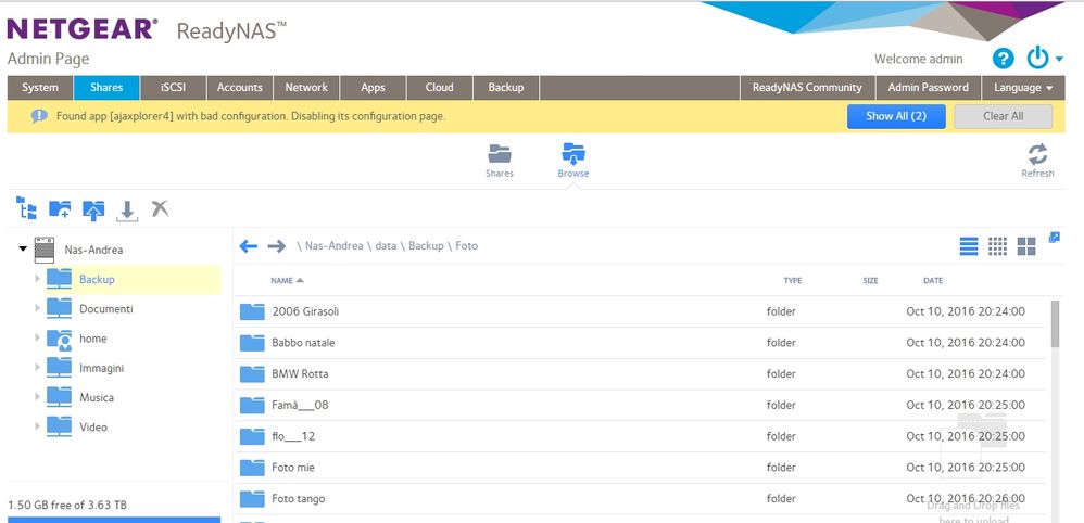

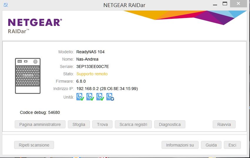

Hi froglet,
I tried to shutdown and restart the system many time ... without result. Everything remained frozen as before. So I was obliged to use the technical assistance by netgear ... it seems that they have solved the problem, the resync process restarted and now the situation look at least normal. I see my data in the volume first of all!!
Afetr resync is completed I would be sure about the result but just now I now I have no lost my data!! This is a wonderful news for me.

Hi,
the situation after the restart of sync was the following ...
My data are there as in the initial situation and I can sse them but not access to them until now at least. I hope this is useful for you. regards
