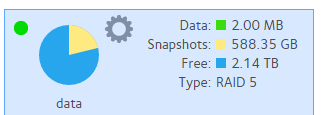

Hi Folks, Hoping for some help here. My issue started with an alert on a disk 1 failure, a day after that the NAS froze up and the only way to reboot it was to power cycle the system. After tha...

I can see your array is currently doing a resync

Since all that has been mentioned is that I should have several different backups I assume my snapshots are useless?

Snapshots do not provide redundancy. They allow you to rollback a file share/LUN to how things were in the past frozen at a point in time or in the case of ordinary file shares recover a subset of your files/folders on the share from a given point in the past (rather than needing to roll everything back).
Like RAID snapshots can help reduce the likelihood of needing to do a full restore from backup, but they are not a replacement for backups.

Snapshots are useless, but it must be stressed that they are not a replacement for backups. Also snapshots are more appropriate for some use cases than for others.
Should you wish for support to make an attempt to recover your data, your snapshots may yet prove crucial to the chances of success.
