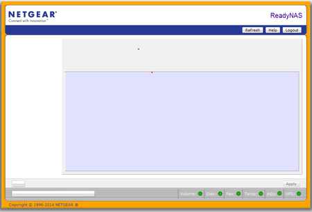

Hi SamirD , StephenB , mdgm Have tried FF 52 esr this morning and it makes no difference. Made sure Antivirus shields were off when attempting connection, as this seems to be the only way my network allows me to talk to the unit. All I get is -
Funny though - If I switch to the shares directory, I do get some functionality to change the admin password, but I have always been able to do this in the many browsers I have tried.
I think that there is still something wrong with the VPD file, as this unit displays differently in RAIDar than my others, with no model number specified and a completely missing serial number section.
