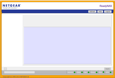

ReadyNAS 2100 FrontView blank page - Firmware 4.2.31
Hi, Not sure If I am in the right place but here goes as I need some help. I have three readyNAS 2100's. I have had no issue installing OS6 on the first two. This third one did not like it an...

Hi SamirD , StephenB , mdgm Have tried FF 52 esr this morning and it makes no difference. Made sure Antivirus shields were off when attempting connection, as this seems to be the only way my network allows me to talk to the unit. All I get is -
Funny though - If I switch to the shares directory, I do get some functionality to change the admin password, but I have always been able to do this in the many browsers I have tried.
I think that there is still something wrong with the VPD file, as this unit displays differently in RAIDar than my others, with no model number specified and a completely missing serial number section.

Yes. That RAIDar output indicates that the VPD has been wiped.

Yes mdgm , but as detailed earlier in this thread I have followed a tutorial on copying a VPD file from one 2100 to another, successfully. Would you see this behavior If the VPD was not it's original?
- mdgmDec 21, 2022VirtuosoCopying the VPD from one unit to another is not the recommended way to try to fix this problem.
Also, the 2100 V1 and V2 are very different units to each other.
If after fixing the VPD if that was successful you did a USB Boot Recovery that could have messed it up again. - StephenBDec 21, 2022Guru - Experienced User
