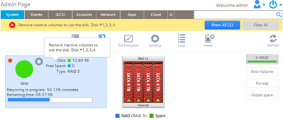

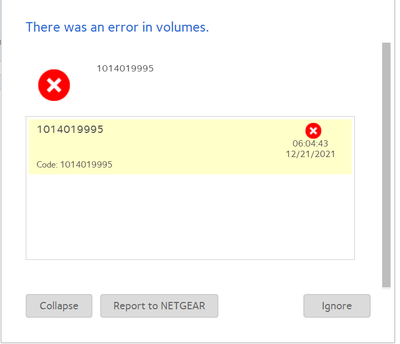

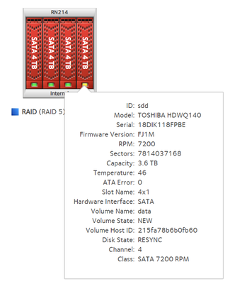

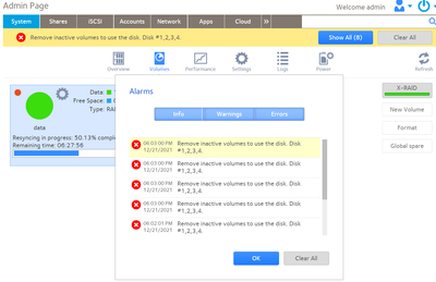

Hi all!
I have a similar problem: error 1014019995
Model ReaduNAS 214
Firmware 6.10.6
Type RAID5
How can I solve this problem and restore the data?
