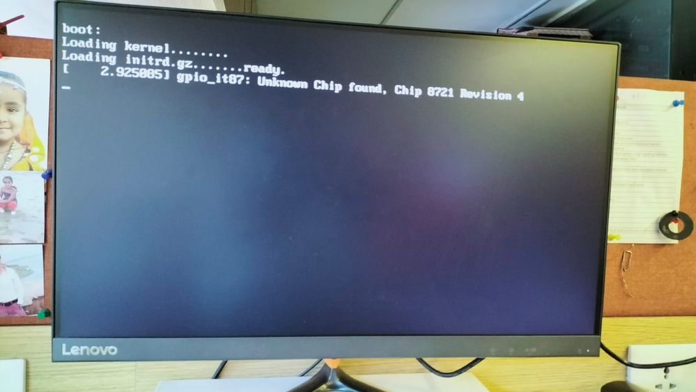

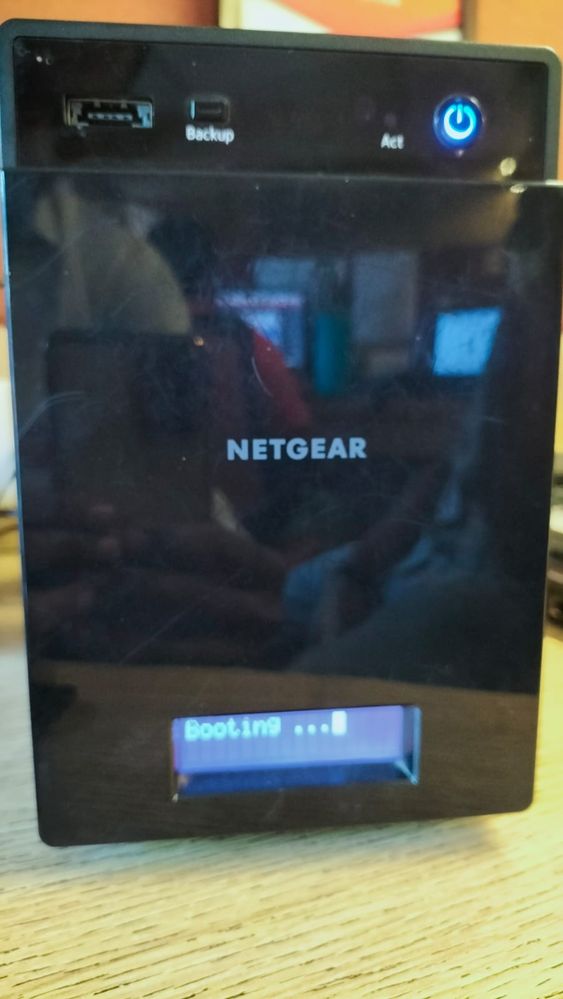

Does this happen every single time you power up the NAS?
As I observed, It is happening when the NAS is powered of without normal shutdown.
Have you ever seen it happen when you simply restart it (leaving it powered)?
No. Issue is not happening when doing normal shutdown and restart.
Have you tried running the diagnostics from RAIDar?
Ran the test. Showing not any error.
StephenB
May 29, 2023Guru - Experienced User
kalpsr wrote:As I observed, It is happening when the NAS is powered off without normal shutdown.
Actually I'm not seeing that in either thread. You said
When I start the NAS first time, it is being stuck at Booting...
Then I do power off and start it again, it will boot normally.
I don't see anything about how the NAS was shutdown before the failure to boot, and I don't see anything that says whether this happens 100% of the time.
I am asking this: When you power down the NAS with the preferred shutdown, does it always fail to fully boot when you start it up again? Or does it sometimes boot normally?
- kalpsrMay 29, 2023Aspirant
Yes always, with Booting... message only.
Then i will have to power off manually by pressing power button.
Once in a while it boots normally.
