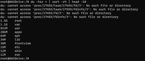

ReadyNas 316 - Mono - radarr /root 99%
Hi, I use my NAS soley for media and file storage and recently install radarr using this guide but now I seem to be running into issues where plex stops working or crashes the NAS. I delete a bunch...

hazelbag wrote:
StephenB Could you maybe guide me with removing mono and sonarr?I've not installed them myself, and the details will depend on what you did. apt-get remove --purge should work for things you installed with apt-get.
- hazelbagApr 05, 2021Aspirant
Thanks StephenB
Yeah I used apt get for mono, added
StephenB wrote:I've not installed them myself, and the details will depend on what you did. apt-get remove --purge should work for things you installed with apt-get.
mono-devel mediainfo sqlite3 libmono-cil-devSo using apt-get remove mono-devel mediainfo libmono-cil-dev --purge will then do the trick?
Then for radarr, would I just delete it in the opt folder? as per the link I followed here
- StephenBApr 05, 2021Guru - Experienced User
You do need to delete the .service file you created. I'd stop the service before deleting anything
systemctl stop radarr
You don't need the sudo if you are logged in as root (which is what you should be doing).
In general you want to go through the process backwards (removing radarr before running apt-get remove).
hazelbag wrote:So using apt-get remove mono-devel mediainfo libmono-cil-dev --purge will then do the trick?Not sure if it matters, but I think you need to put the --purge right aftger the remove.
