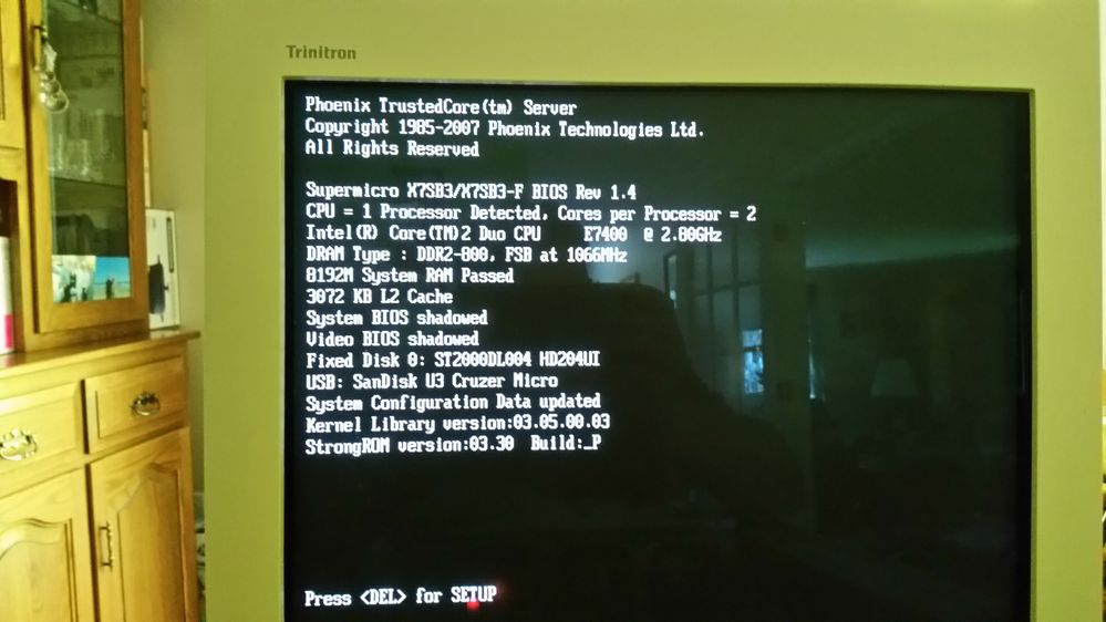

      Well, nobody ever said this was going to be easy ... looks like Sandshark's concerns were valid.  I received the unit and attempted to implement the USB recovery process with a VGA monitor installled on the unit so I could observe the process in action.  The recovery USB booted and progressed, showing
      "SYSLINUX 3.73 2009-01-25 EBIOS Copyright (C) 1994-2008 H. Peter Anvin"
      "Loading kernel ......."
      "Loading initrd.gz ....................... ready."
      After that, there was no more activity on either the recovery USB or the internal USB.  I'm fairly confident that the drive I'm using as the internal USB is acceptable to the system since I'm using one that previously booted numerous times as a recovery USB on this system.
      During one of my attempts, I noticed a quick flash on the screen, so I installed a keyboard so I could pause the system and what do you know?  There was the screen for "Supermicro X7SB3/X7SB3-F BIOS Rev. 1.4"  Like I said, things can't ever be easy.
      Looks like I'm to the point where I need to reflash the BIOS on this system with that originally installed by Netgear before it will allow the recovery USB to complete its installation.
      On another note, I also attempted to boot by installing a scratch hard drive that was removed from an OS 6.8.0 Ultra 6 Plus (had installed the single drive and performed a Factory Reset before removing from the Ultra 6 Plus).  As expected (hopes were pretty low at that point), no joy ... the system failed to boot.
      Any advice or suggestions from the community?  Thanks in advance.

        That is very much what I saw when I put a known good internal flash into a non-Netgear motherboard in attempting a repair (on a 4200, but I'm sure it's the same on a 3200).
        While getting the generic SuperMicro BIOS is easy -- it's avalable from their web site -- getting the Netgear one isn't. Unless somebody from Netgear is able to send you a copy of the BIOS, you will have to get the correct BIOS flash utility, copy the BIOS from a working 3200, and install it in yours.  It would be nice if Netgear shared their BIOS so that replacement non-Netgear motherboards could be used to repair units, but that could also allow somebody to build their own ReadyNAS equivalant, something they wouldn't want to help support.
         Even that may not be enough if the model and serial number info in the internal flash is not restored as well.  If you clone one from a working 3200, you'll clone the serial number.  I've looked at a dump of the flash from a 4200, and it was not obvious to me where that information is located.
        Your easiest path is to just use it as a FreeNAS device.  You coul also purchase an unmodified 3200.  The guy I got my 4200 from is selling 3200's on eBay for $169.99 plus shipping.  Mine was clearly unused, though missing the (generic Supermicro) drive caddies.
