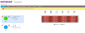

ReadyNAS 3220 Remove inactive Volumes to use the disk Disk 1-12
Hi, Hopefully someone can help. I have a ReadyNAS 3200 Firmware 6.10.7. Running Raid 6. It is used as a backup repository. I was having backup errors in Veeam that the media was write protected ...

There was a firmware update waiting so I applied it - which I realise that I shouldn't have done without checking further first. I now have an error as below
