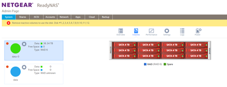

ReadyNAS 3220 Remove inactive Volumes to use the disk Disk 1-12
Hi, Hopefully someone can help. I have a ReadyNAS 3200 Firmware 6.10.7. Running Raid 6. It is used as a backup repository. I was having backup errors in Veeam that the media was write protected ...

There was a firmware update waiting so I applied it - which I realise that I shouldn't have done without checking further first. I now have an error as below

Thanks for your reply. I am able to log into SSH. I note from searching aroung that others have succesfully retrieved data using a command such as
mount -o recovery /dev/md127 /data
But I am unable to see a similar mount volume that I would be able to mount in my case.
