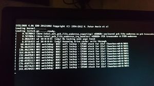

Im back at:
MBR
boot:
Loading krenel........
Loading initrd.gz..........ready
[ 0.939318] [drm:intel_set_pch_fifo_underrun_reporting] *ERROR* uncleared pch fifo underrun on pch transcoder A
[ 0.9393320] [drm:intel_pch_fifo_underrun_irq_handler] *ERROR* PCH transcoder A FIFO underrun
[ 6.860753] sd 10:0:0:0: [sdg] no caching mode page found
[ 6.866243] sd 10:0:0:0: [sdg] assuming drive chache: write through
And Im at 64% and its showing "mdadm.service"
