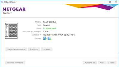

Model : Netgear ReadyNas Duo - RND2000 v2
Firmware : 4.1.16
RAIDar : 6.4.0
Hello everyone,
At the beginning of the year, my father-in-law gave me his old Nas Netgear ReadyNas Duo - RND2000 v2. My problem is that my father-in-law had configured it and does not remember his password anymore. I can just plug it into my network and see it appear.

  • As I continued to study the documentation, I realized that the Rear Panel pictures do not match with my device. While I'm on the right code product page registered under the device : RND2000v2. The documentation refers to this manual while my device corresponds to this manual.
    I did the Factory Reset procedure as for ReadyNas RND1xxx and not as for RND2xxx as my model and it works.

      Netgear made a huge blunder and re-used the "V2" designation.  There are even NASs that say they are a "V3".  But your NAS is clearly a V1 since it runs OS 4.1.x.  A true V2 matches the inage you found.  You cannot upgrade a V1 to OS 5.x or 6.x.
      I see many people selling V1 NASes on eBay as V2 or V3 because that's what's on the paper label.  But the pictures clearly show they are a "true" V1.  So, buyer beware.
