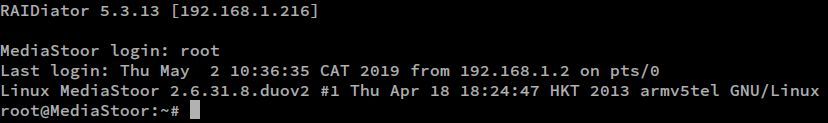

I did this with both drives in the NAS, as I do not know what will happen if the two drives had different data, if left or right would take precedence. I then powered up the ReadyNAS duo v2. by default ssh does not allow passwordless login, the web-interface is not usable, so I connected to the serial port:
# screen /dev/ttyUSB0 115200
Once through the boot sequence, I could log in without a password:
Then created a new password:
# passwd
and did the same for user admin.
