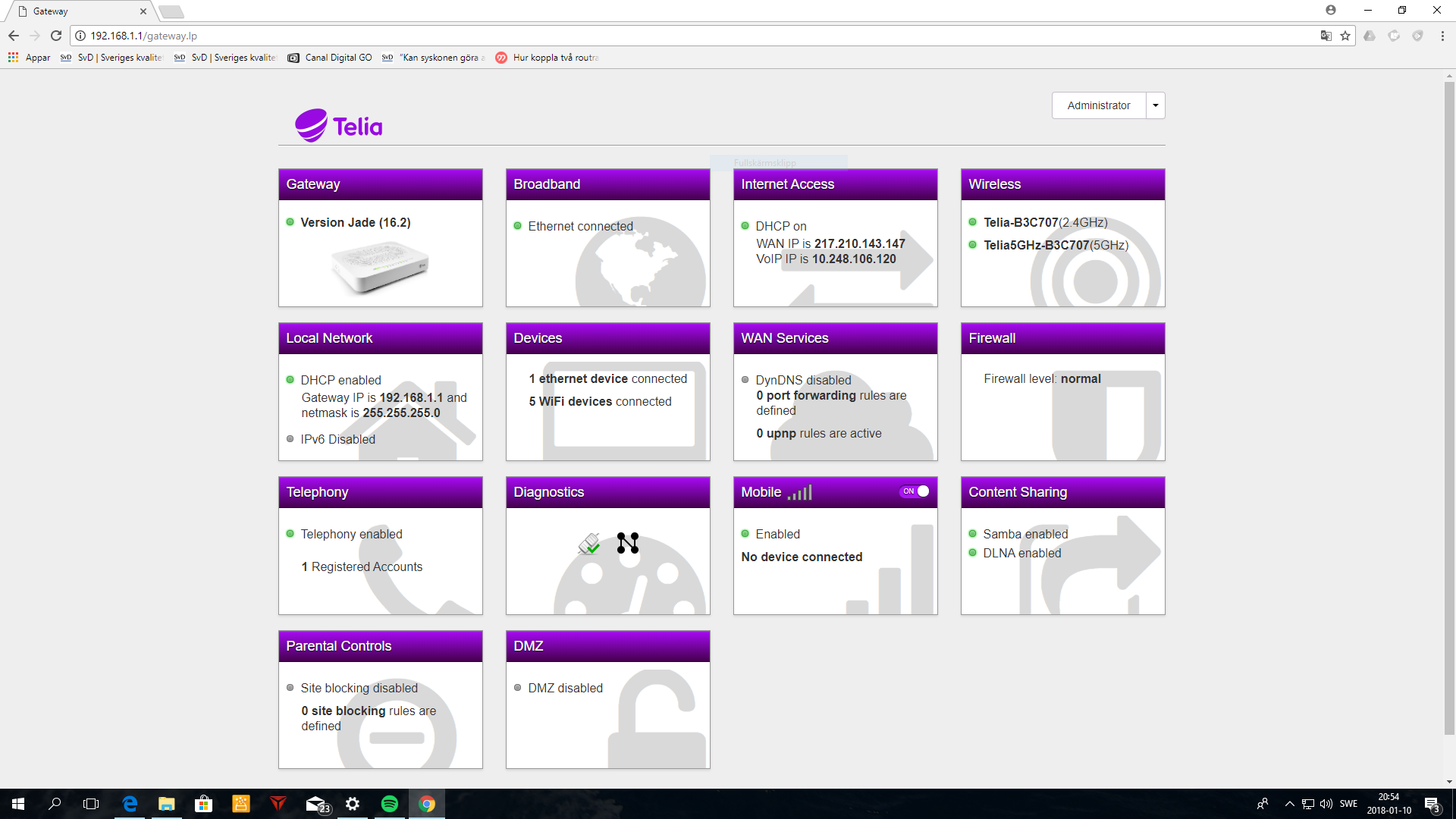

      Huawei using 192.168.1.1  -  192.168.154, Technicolor I can't see, probabl the sam since connected devices hav adree within that range
      I attach main screen for Technicolor
      • StephenB's avatar
        StephenB
        SivertP wrote:
        LED close to "cable entry"  shows activity when connected to Huawei but not to Technicolor
        Is the LED on back of the NAS side?  Or do you only mean the LED on the router?
        Do you have an ethernet switch you can put between the NAS and the Technicolor?
