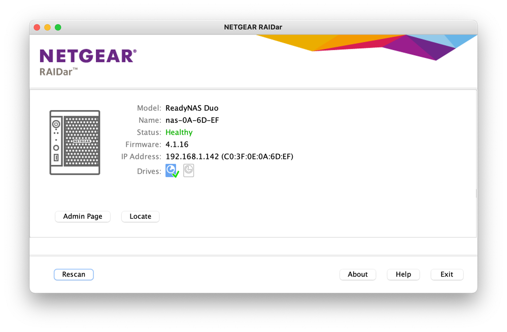

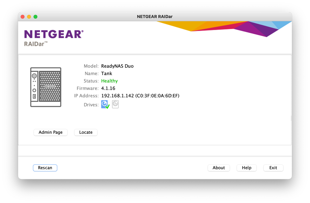

I did as you suggested, in way of pulling the power plug, removing both disks, then powering up. The Duo's LED flash sequence displayed error code 2, and RAIDar reported the same.
Upon powering down, then inserting a disk only in Channel 1, then powering up, the Duo displayed error code 3 as you foretold. I then performed a Factory Reset. For anyone interested, this is how long the Factor Reset process takes:
Then, as you also predicted, I received the Cipher Mismatch error when attempting to access frontview. However, installing Firefox 94.0.2 was the workaround. I'll look at your other suggested workarounds for that later, thank you. For anyone interested - I suggest disconnecting from the Internet after downloading Firefox 94.0.2, then open it and click Firefox > Preferences, scroll to Firefox Updates, and select "Check for updates but let you choose to install them".

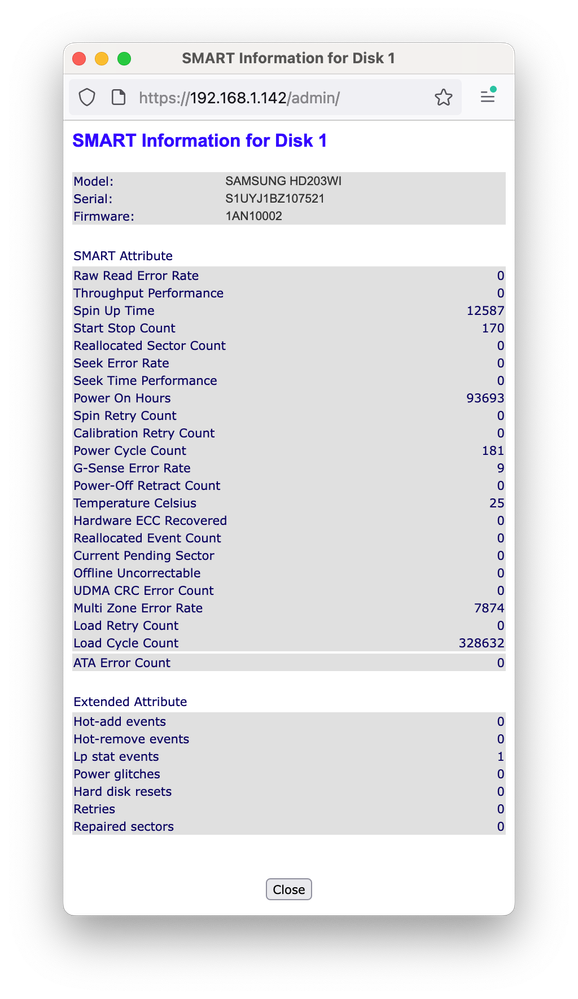

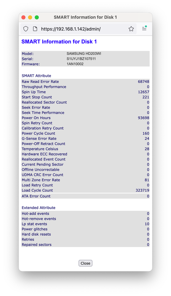

I'm concious of not wasting yours or anyone else's time here, so I'm just collecting further info. I'll start referring to my three disks as Disk 1, Disk 2, Disk 3, where 3 is the newly purchased one. Will reply with results shortly.
- JaydenLSep 02, 2022Aspirant
I assume that by these results, it's probably clear that Disk 1 is toast. I'm unsure how to decypher these reults tho.
Disk 1:
Disk 2:
Disk 3:
So I am going to shelve Disk 1 for now, and won't use it again. I assume this was the one that was giving S.M.A.R.T. issues over the last couple of years that I should not have ignored.
