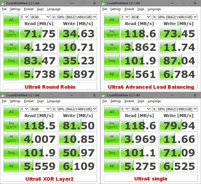

New benchmarks, now on Ultra6. This is really different
- Switch Fault Tolerance (SFT)
