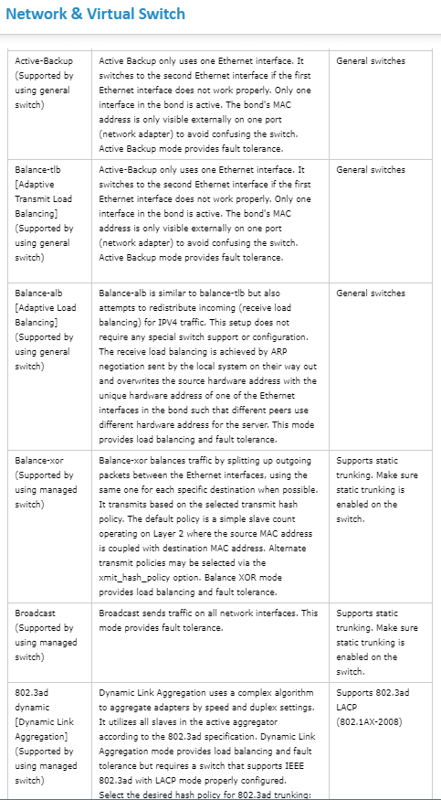

    Borrowed from a competitor (QNAP QTS) an overview of which trunking modes are requiring what kind of switches and switch configurations:
    FMI: http://docs.qnap.com/nas/4.3/cat2/en/index.html?network.htm

      Thanks for that. I found the equivalent Netgear version: https://kb.netgear.com/23076/What-are-bonded-adapters-and-how-do-they-work-with-my-ReadyNAS-OS-6-storage-system
