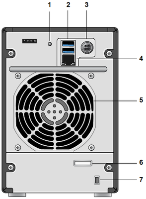

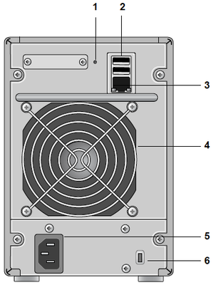

As long as the RND4000-200NAS Unit you will purchase has the 3 pronged socket like the 100NAS. There are RND2000-200NAS that uses a 4-PIN DC DIN AC plug which is the NV+v2.
This is for the NV+v1
This is the NV+v2
You have to make sure you are getting the correct version for your RND4000 PSU replacement. Here's a link to know the differences of both versions.
