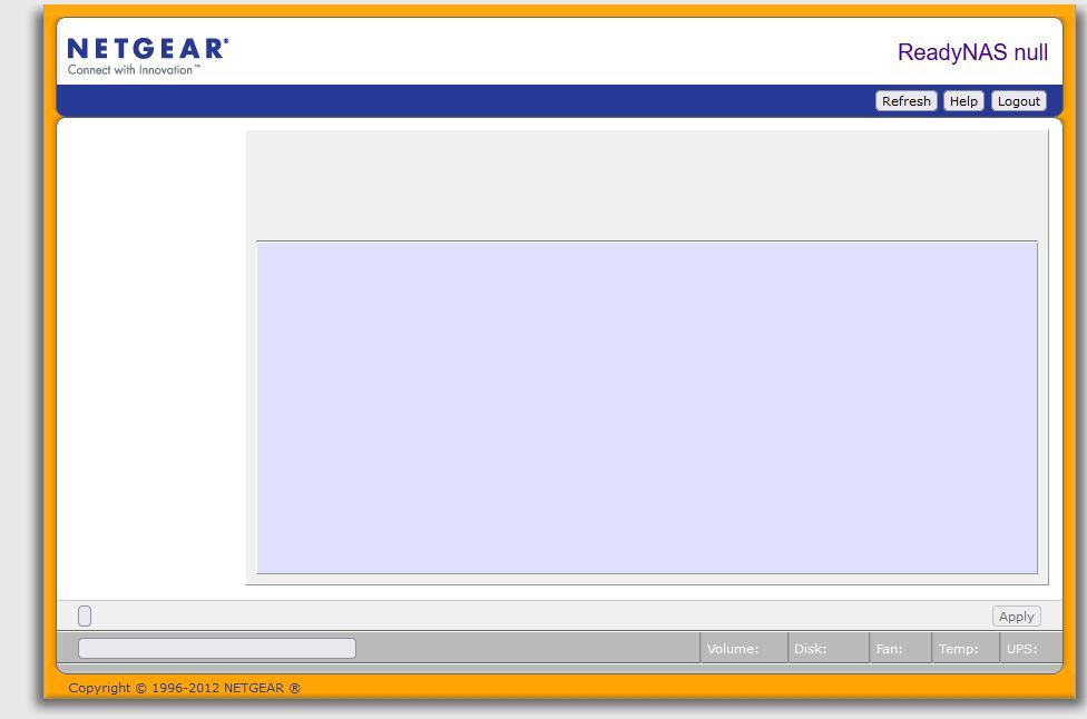

btw: when trying to acces the device with a browser (Frontview, https://IP-address/admin/), on a Windows7 PC the http request is answerd with just the HTML "frame" of Frontview and that's it (see screenshot).
