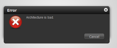

- khyretosApr 29, 2024Aspirant
BTW, the apache2 fix does not work in this model because the architecture is ARM and if i try to drop it i get "Architecture is bad"
so i guess my only option to make it work is to do the SSH thing and adjust the settings.
