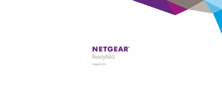

ReadyNAS OS 6.10.5. Connect to Admin page for a few second, after: "Connecting to the ReadyNAS Admin
Hello. NetGear RN10200 ReadyNAS OS 6.10.5 Problem: connects to the admin page for only a few seconds, then the message: "Connecting to the ReadyNAS Admin Page" The system is fully operation...
