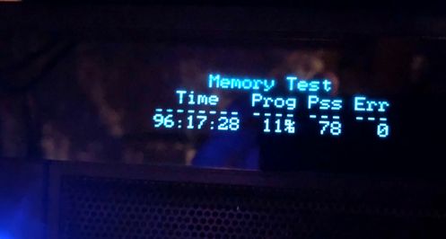

Have you tried running the memory test boot menu option? - budda1Jun 14, 2018Aspirant
I have not tried the memory test, I didn't know it was possible - but have just read the KB article on how to do it so will give it a go.
- budda1Jun 20, 2018Aspirant
How long does a memory test usually take? I've had it running for a number of days now. I took a quick screenshot of the ReadyNAS LCD yesterday.
Do I just leave it to crack on until I get to 100% prog or does it loop around and start again?
- mdgm-ntgrJun 21, 2018NETGEAR Employee Retired
On the Pro it'll keep on running additional passes till you stop it. You could have stopped it after running just two or three passes, I think.
- budda1Jun 21, 2018Aspirant
Ok, so it passed okay enough times then. I'll stop it in the morning as the ReadyNAS lives in the loft out of the way.
