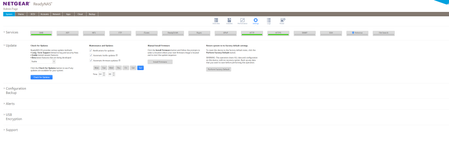

Readynas RN214 crashing a few minutes after booting.
I have 2 RN214 units in my office. One works faultlessly and the other did but now crashes a short while after booting. Both are 214s running 6.10.8 firmware. Neither system is more than 65% full. ...

I've booted the unit up in read only mode and it certainly stays alive longer, more than a few minutes, than in normal mode. So I'm assuming the problem is something is trying to write to the discs and causing the issue.
I gave the unit half an hour and then rebooted in normal mode. Same problem, as expected. However I tried to start disabling the snapshots but the unit crashed before any of the changes could be applied. Naturally I can't make changes in read-only mode so how would you suggest I proceed from here, please?
