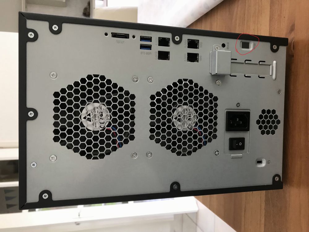

Hi JohnCM_S at the place with the descirption UART there is a solit black square. It is not someting where I can put a Micro USB cable in. Am I looking at the right place on the chassis?
- StephenBApr 29, 2019Guru - Experienced User
ronaldvr2132 wrote:
Hi JohnCM_S at the place with the descirption UART there is a solid black square. It is not someting where I can put a Micro USB cable in. Am I looking at the right place on the chassis?
It is the right place. You pull off the black square.
