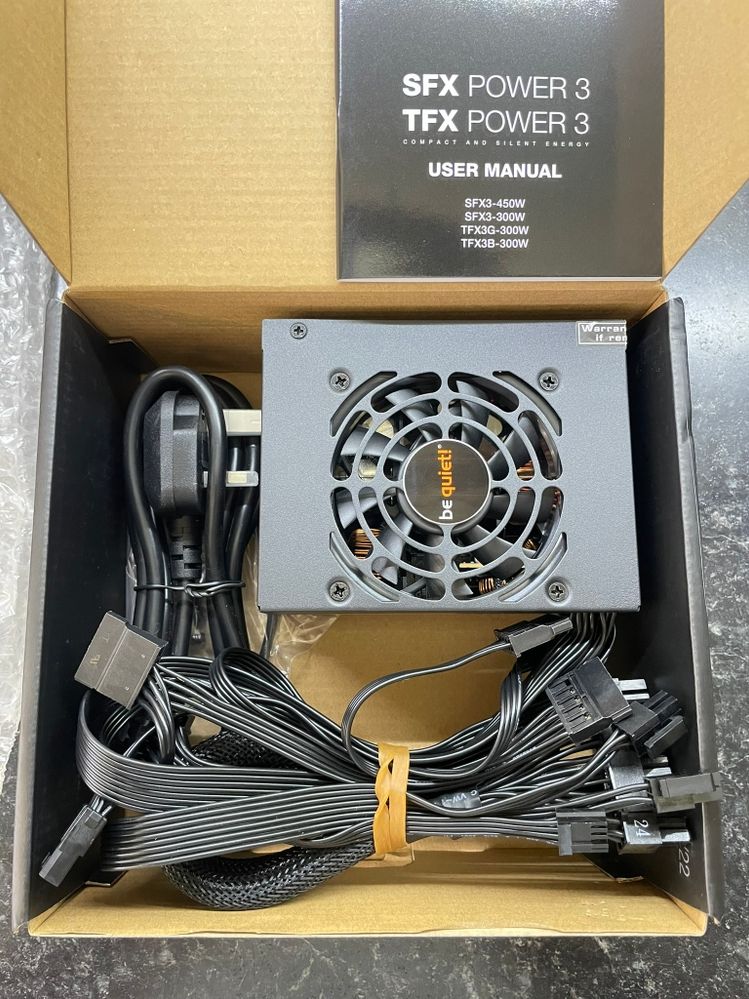

- xlr8rJan 25, 2024Luminary
Did a bit of PSU hunting online. I seen that ready made one you mention on eBay but looking at the actual PSU, I believe it may be one of the very cheap unbranded type. So, I have purchased one of these instead which will hopefully do the job. (i would have preferred a 'modular' PSU, but this may do for now).
https://www.bequiet.com/en/powersupply/2309
(I bought mine from Scan)
I will be "butchering" the heck out it today (hopefully), cutting and shortening its cables and will professionally splice on the 3x old 90 degree MOLEX connectors (I ordered some extra from Shakmods, just in case...).
I might also shorten the 4pin CPU cable as well.
I also ordered up a couple of 24pin motherboard power extensions (4", 6", 8").
[ 18 AWG 24pin extension - link - Amazon ]
I'll cut off and terminate any unneeded cabling to avoid clutter and keep airflow to a max, and will "braid" all cables for a bit of extra protection.
May as well upgrade the CPU fan (and Case fan (Noctua) while I'm in is far...
The one thing I didn't think of, now that I'm looking at the new be quiet! PSU, is its fan location... Its 'off-centre' for some reason and may not match up with the Readynas fan-slot... so some further modifications my be needed on that,
fingers crossed - wish me luck lol
will post back with result and a few pics of process.
cheers to all

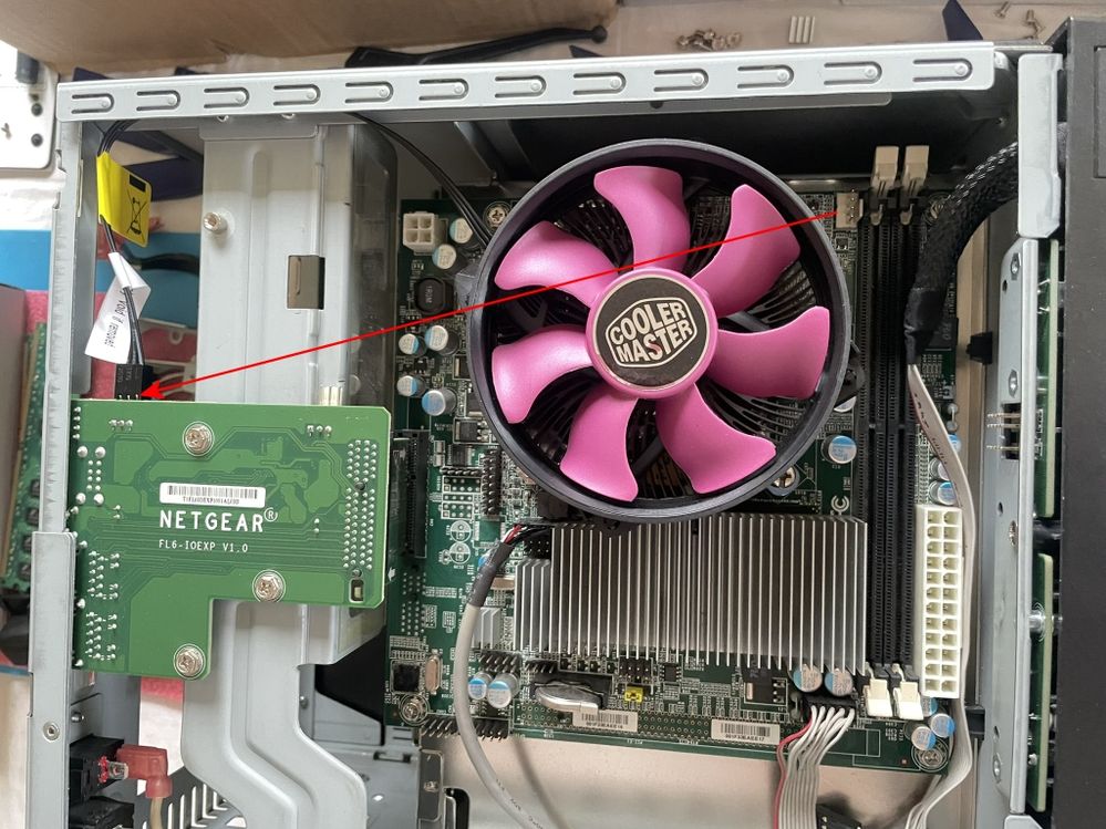

I do have a question though before starting with the CPU fan upgrade.
I found an old Cooler Master intel fan in storage (new, old stock) and it pushed onto the heatsink (was tight, but will go on), but its only a 3-pin. (i checked clearance with the side case panel and there was a 2-3mm clearance. So , eve if it does loosen, it cant actually go anywhere).
The original Readynas CPU fan has 4-pins, and on my NAS was connected to the MAIN board. My question then is, if I change that and connect the new CPU fan to the daughter board (3-pin) will OS6 be able to detect and control it without any software modification ?
