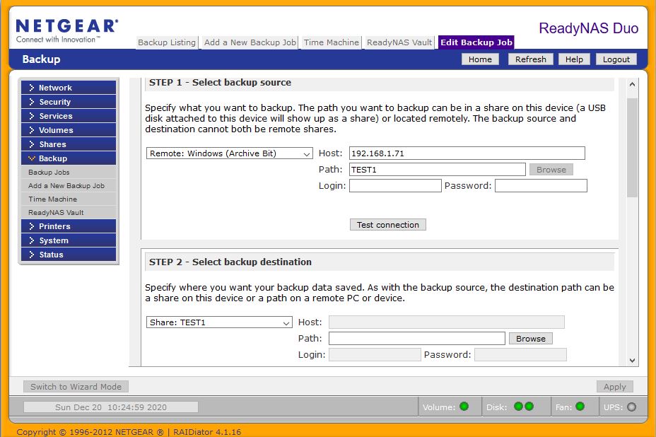

I have set up a new folder called TEST1 (all uppercase) on my computers C drive. This folder has one excel file in it.
I have shared this folder to everyone. It now shows as shared:
\\Jason\test1
On the ReadyNAS I have set up the new share, public was ticked. CIFS is enabled to read/write. HTTP/S is disabled.
I attach a capture of the backup page settings.
Once I select GO, the Status turns to starting, then the email comes in from the NAS alert system saying:
Error encountered copying data from remote source path //192.168.1.71/TEST1 ==> /TEST1/ due to permission denial on one or more files

Error encountered copying data from remote source path //192.168.1.71/TEST1 ==> /TEST1/ due to permission denial on one or more filesOn the computer running windows 10 - again, I have checked that : Turn windows features on or off - SMB 1.0/CIFS File sharing support is ticked.
This has enabled all three subfolders: SMB 1.0CIFS Automatic removal,SMB 1.0CIFS Client and SMB 1.0CIFS Server.
I don't know what else to do - as this is very much a learning curve for me, being new to NAS storage.
Thanking you again, very much in advance for your time.
Jason C-P.

As I tried to say before, there are two different sets of permissions on the PC (and the NAS for that matter). One is the network permissions (e.g., sharing). The other is the file permissions (which apply even on the same machine). I suspect your problem is that the file permissions are not allowing access.
If you are using a local Windows account (not the microsoft one that uses an email address), you can put the windows username and password in the backup job.
Or you can right-click on the TEST1 folder on the PC, and look at the file permissions there (and make sure that everyone access is set up for the folder and all files that are in the folder).
Or you switch to FreeFileSync (or some other backup tool running on the PC), and set the backup destination to be the NAS. Then you don't use the backup jobs in the NAS at all.
