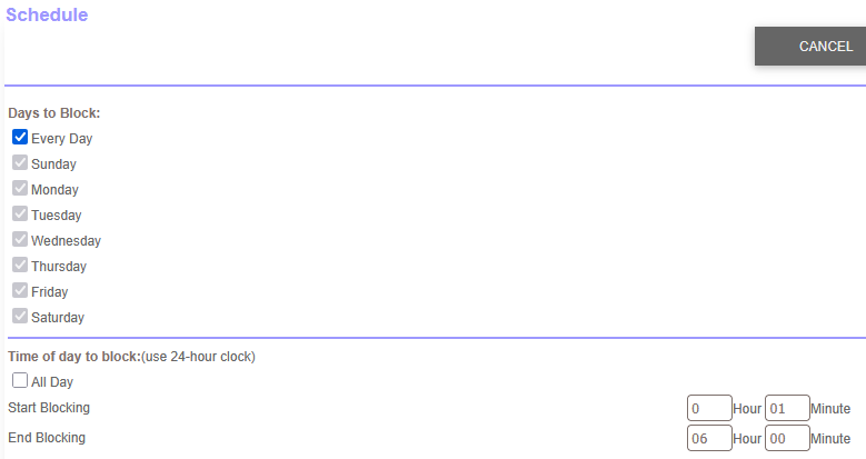

  • CrimpOn's avatar
    CrimpOn
    There may be an issue with "midnight".  Can you try turning WiFi off at 12:01AM and back on at 6:00AM ?
      • Sewell1655's avatar
        Sewell1655
        Thanks....but the time can only be set by 1/2 hr increments.
        The time zone was set to Pacific time. Needed to be Atlantic so that may have been the problem.
        Will find out tomorrow morning!!
        Thanks for the reply!!!
        Ken
  • CrimpOn's avatar
    CrimpOn
    Thanks for the info. (I should have looked that up.) Hmmmm.  I just set up this schedule on my ancient Orbi router:
    Hit "Apply" and it took.  My (very dim) memory of when I tried this YEARS ago was that the "off time" had to be in the same 24 hour period as the "on time" and midnight was "yesterday".
    But. it's pretty clear that my router and yours may be very different (and my memory not all that useful). What IS pretty clear is that MY router requires Start of Blocking to come BEFORE End of Blocking.
