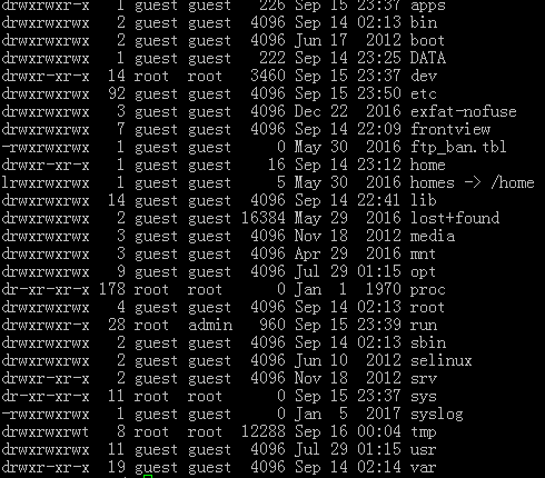

    • z00's avatar
      z00
      Thank you for your reply.
      The app is LogAnalyzer. When installing, it tells there's some permission error about rsyslogs.
      After uninstlling the app by apt-get, I checked the owner of files you metioned and changed owner to root.
      At first, smb service can be activated. However, after reboot, smb service was turned off again.
      Then I checked all the files owner and found almost of files in root directory were changed to guest:guest.
      So I want to change owner of them all to root. But I make a big mistake.
      root@z00-nas:/# chown root:root -R *
      chown: changing ownership of 'DATA/home/admin/.ssh/ssh_authorized_keys': Operation not permitted
      chown: changing ownership of 'home/admin/.ssh/ssh_authorized_keys': Operation not permitted
      chown: changing ownership of 'proc/sys/debug': Operation not permitted
      After reboot, I cannot ssh to the NAS anymore...
      Because the user of the website is admin, I also cannot use website to change anything, inclued reinstall the firmware.
      I tried to use boot menu to reinstall OS, but the boot menu only canbe selected to Nomal, neither OS reinstall or Factory default shown.
       As I used X-raid, I cannot use other computer to read the data from the harddisk. Is there any other method to reinstall OS?
