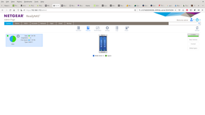

ReadyNAS 212 - Version 6.10.6 I had a whole series of error messages from one of the drives yesterday afternoon (both drives are under 3 years old) - as per the attached log screenshot. Today I ...
I had a whole series of error messages from one of the drives yesterday afternoon (both drives are under 3 years old) - as per the attached log screenshot. Today I did a disk check and it has come back told me that I have a disk failure - again as per the screen shot, but the main overview pages are telling me that everything is healthy and the disks are fine.
How can I tell if I have serious disk problem and a disk needs to be replaced?
The sharp rise of ATA errors ( over 400 errors in about 30 minutes) is definitely concerning. One option (given the rather low cost of these drives) is to simply replace it, and be done with it.
FWIW, it's pretty common for the ReadyNAS screens to show that disks are healthy when in fact they aren't. Part of the puzzle is that there is often no bright line between working and failing. Netgear has higher thresholds (more tolerant of errors) than I personally do. I periodically look at the underlying SMART stats and make sure the disks are healthy.
Unfortunately, there are no common health thresholds for ATA, reallocated sectors and the like. Various vendors have their own thresholds in their disk diagnostics (Seatools in this case), but many people will pull disks with errors even if they pass those tests.

I ran the disk check and it said the disk failed:
Volume: Disk test failed on disk in channel 1, model ST4000VN008-2DR166, serial ZDH7GEW4.
...but the disk still shows as being ok on the main screens. Anyway, the seller got back to me and have agreed to replace the drive even without it having 'failed' per se. I've ordered a replacement and the failing drive will go back to them.
