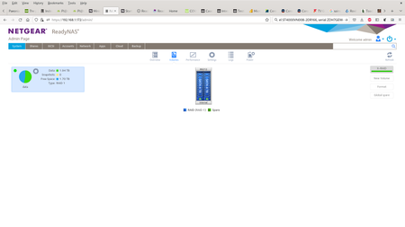

ReadyNas212 - Disc errors but discs show ok
ReadyNAS 212 - Version 6.10.6 I had a whole series of error messages from one of the drives yesterday afternoon (both drives are under 3 years old) - as per the attached log screenshot. Today I ...

I ran the disk check and it said the disk failed:
Volume: Disk test failed on disk in channel 1, model ST4000VN008-2DR166, serial ZDH7GEW4.
...but the disk still shows as being ok on the main screens. Anyway, the seller got back to me and have agreed to replace the drive even without it having 'failed' per se. I've ordered a replacement and the failing drive will go back to them.
Yes, that's unfortunately common.

...just a quick addition....
The lights on the NAS seem to show the disks (both) as ok and the web based software shows them both ok although the disk check shows a failure. Does that mean the disk has actually failed? And how do I know which disk has then failed? Is it a case of taking out a drive at a time and looking for the serial number quoted in the error log?
