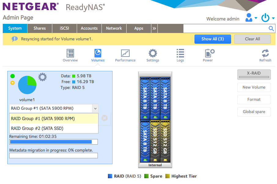

Hi,
I've got a NAS Pro 6-bay system, currently on NASOS 6.9.5 hotfix 1 and loaded with 4 x WD RED 8 TB drives in FlexRAID RAID 5.  Primary use case for the unit is as an NFS server for my VMware ESXi system with about 400 GB of active VMs.  There's also a few terabytes of general file server stuff, but it's not frequently accessed.
I've ordered a pair of Samsung 860 PRO 512 GB SSDs and 2.5->3.5 mounting adapters that should let them mount correctly to the NAS sleds, and they should be here Tuesday.
So...here's my putting-the-cart-before-the-horse question:  Do you know of any reason this shouldn't work when adding a 512 GB RAID1 SSD tier to the existing volume?  At 6.9.5, I should be able to tier metadata, and when 6.10 shows up for available update (I'm not going hunting for it), I can switch it to data tier...modified data per day/week really shouldn't exceed the capacity of the SSDs...this is mostly stuff like mail servers and Gitlab servers for a really small (< 10 people) organization.
For that matter, do you know of any reason that 6.10 shouldn't run on this machine?  It's populated with 4 GB RAM.
Thanks in adavance...

  • Okay, I fibbed about waiting for the update to be prompted.  I had some slack time tonight and went ahead and shut down all VMs and updated the NAS to 6.10.0...it succeeded and promptly updated itself to 6.10.0 hotfix 2 upon rebooting, and all appears to be well.  SSDs and mounting adapters are still projected to arrive tomorrow, so hopefully we press the big "go faster" button then.
    I haven't been able to find the reference I saw earlier about removing the SSD tier once it's in place, but I would SWEAR that it said you could remove the tier RAID group without losing the volume.  Would REALLY like to find that again before I take irreversible steps.
  • Metadata took about 1.5 hours to sync to the SSDs, and the entire volume resync is 98.3% done...maybe about 2.5 hours total to complete?  Totally guessing.  A total of 8 GB of metadata and so far 15 GB of data allocated to SSD.
    Best performance seen in the graphs so far is 3500 write/1700 read IOPS.  Not bad.  CPU temperature went up about 10C when it was syncing metadata, but it's already dropped back down to normal.
    Resync 98.65% done while I've been sitting here blathering.
