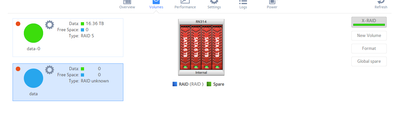

Remove inactive volumes to use the disk. Disk #1,2,3,4.
Hey guys,
Screen shots say a thousand words.
It seems that the array is damaged and cannot be resynced on its own.
[22/04/03 01:00:45 AEDT] warning:volume:LOGMSG_HEALTH_VOLUME_WARN Volume data is Degraded.
[22/04/03 05:39:46 AEST] warning:volume:LOGMSG_HEALTH_VOLUME_WARN Volume data is Degraded.
[22/04/03 09:04:12 AEST] notice:system:LOGMSG_ANTIVIRUS_DEF_UPDATE Antivirus scanner definition file was updated to 62.26500.
[22/04/04 01:00:50 AEST] warning:volume:LOGMSG_HEALTH_VOLUME_WARN Volume data is Degraded.
[22/04/04 09:04:13 AEST] notice:system:LOGMSG_ANTIVIRUS_DEF_UPDATE Antivirus scanner definition file was updated to 62.26501.
[22/04/05 01:41:54 AEST] warning:volume:LOGMSG_HEALTH_VOLUME_WARN Volume data is Degraded.
[22/04/05 09:04:12 AEST] notice:system:LOGMSG_ANTIVIRUS_DEF_UPDATE Antivirus scanner definition file was updated to 62.26502.
[22/04/05 15:26:32 AEST] notice:volume:LOGMSG_DEFRAGSTART_VOLUME Defragmentation started for volume data.
[22/04/05 15:38:31 AEST] notice:volume:LOGMSG_DEFRAGEND_VOLUME Defragmentation complete for volume data.
[22/04/05 15:38:42 AEST] notice:volume:LOGMSG_HEALTH_VOLUME Volume data health changed from Degraded to Inactive.
[22/04/05 15:38:42 AEST] err:disk:LOGMSG_ZFS_DISK_STATUS_CHANGED Disk in channel 2 (Internal) changed state from ONLINE to FAILED.
[22/04/05 15:45:53 AEST] warning:disk:LOGMSG_DELETE_DISK Disk Model:WDC WD60EFRX-68L0BN1 Serial:WD-WX61DC7814PU was removed from Channel 2 of the head unit.
[22/04/05 15:46:18 AEST] notice:disk:LOGMSG_ADD_DISK Disk Model:WDC WD60EFRX-68L0BN1 Serial:WD-WX61DC7814PU was added to Channel 2 of the head unit.
[22/04/05 15:47:54 AEST] notice:disk:LOGMSG_ZFS_DISK_STATUS_CHANGED Disk in channel 2 (Internal) changed state from RESYNC to ONLINE.
[22/04/05 15:55:02 AEST] notice:system:LOGMSG_SYSTEM_REBOOT The system is rebooting.
[22/04/05 15:58:40 AEST] info:system:LOGMSG_START_READYNASD ReadyNASOS background service started.
[22/04/05 16:33:31 AEST] warning:disk:LOGMSG_DELETE_DISK Disk Model:WDC WD60EFRX-68L0BN1 Serial:WD-WX61DC7814PU was removed from Channel 2 of the head unit.
[22/04/05 16:33:51 AEST] notice:system:LOGMSG_SYSTEM_REBOOT The system is rebooting.
[22/04/05 16:58:31 AEST] info:system:LOGMSG_READYNASD_ABORTED_NOINFO ReadyNASOS service or process was restarted.
[22/04/05 16:58:55 AEST] info:system:LOGMSG_START_READYNASD ReadyNASOS background service started.
[22/04/05 17:00:13 AEST] notice:disk:LOGMSG_ZFS_DISK_STATUS_CHANGED Disk in channel 2 (Internal) changed state from RESYNC to ONLINE.
Volume was degraded.
But showed all discs online.
Started going though the tests under volume starting with defrag
disk 2 crashed, reseated the disk
came from resync to online very quickly
restarted the NAS
broken
I'm pretty sure I can fix this on my own if someone can point me in the right direction? I'm assuming I need to force a resync over SSH, but not sure how to kick that off?
Thanks guys

    Start by powering down, and removing disk 2.  Then reboot the NAS read-only using the boot menu and see if your data is back (with the volume degraded).
    Instructions for the boot menu are on page 74-75 here: https://www.downloads.netgear.com/files/GDC/READYNAS-100/ReadyNAS_%20OS6_Desktop_HM_EN.pdf
    If that fails I'd contact paid Netgear support.  I believe you need ProSupport, not gearhead.
    If it works, post back and let us know.

      If you could help me out with the name of the split array in the above screen shot ill see if I can find something on my own 🙂

        There are several possible causes that can lead to an unmountable volume, and it is really difficult to sort out the cause (and therefore the right intervention) in the forum.  If you don't already have the needed skills with linux, there is a big risk that your attempts to resolve it on your own will make recovery of the data more difficult or impossible.
        I don't want to be in a position where someone trying to follow my advice ends up losing their data. Therefore I always recommend paid support for this. They can access your NAS remotely, trouble shoot the problem, and if needed offer a data recovery contract.
        If you have a backup of the NAS, you can of course do a factory default, rebuild it, and restore the data from backup.
        You could also connect all the disks to a Windows PC, and use RAID recovery software that supports BTRFS.  ReclaiMe is one package that several users have used with success.
