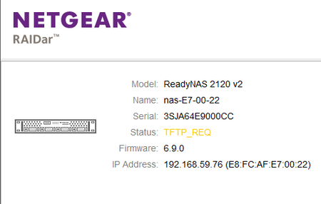

RN 2120 v2 is stuck in TFTP_REQ mode and will not repond to anything other than TELNET on port 23
Hi,
a little while ago i was trying to get a RN2120v2 to update, see thread Here
I have now removed the NAS from full time service so can now spend the nessasary time to get it back up and runni...

That's a guide for an OS 4.1 system, not OS-6. With OS-6 you can start raid and chroot by entering
# rnutil chroot
You can then mount the data volume (assuming healthy disks) using
# btrfs device scan
# btrfs fi show
# mount /dev/md127 /data

Thanks. For the reply.
Will I need the original set of 4 drives for this to work, because I put them in to the new nas that replaces this device,
Can I get this working with a single 250gb drive as proof of working before I shell out for another set of hard drives for this nas.
I don’t mind putting new drives in it if I can get it to work as intended?
Raelrigs
Raelrigs
- StephenBMar 25, 2019Guru - Experienced User
The OS is installed onto the disks (and the NAS then boots from the disks). If the NAS is diskless, there is nothing to repair.
raelriggs wrote:
Can I get this working with a single 250gb drive as proof of working before I shell out for another set of hard drives for this nas.Yes, but the test is just to see that the NAS does it's normal factory install, and that you can access it normally.
- StephenBMar 26, 2019Guru - Experienced User
To clarify, if the flash itself is corrupted then a USB recovery procedure might repair that. If that fails, then you could check the warranty status and if you are covered you could request an RMA.
