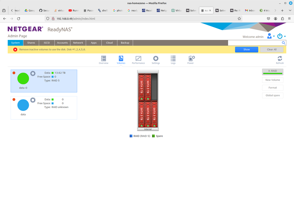

- halbertnApr 06, 2024Aspirant
StephenB Sandshark
I finished converting all my img to .vdi so that I could mount them using virtualbox. I assigned each drive as follows:ReadyNasVM.vdk - SATA port 0
Disk1.vid - SATA port 1Disk2.vdi - SATA port 2
Disk4.vid - SATA port 4
Disk5.vdi - SATA port 5
Disk6.vdi - SATA port 6
I intentionally skip SATA port3 as that should be the slot at which disk3 went in, but my disk3 clone was bad, so I'm ignoring that slot for now.
I boot up the VM in VirtualBox. However, my Raid5 volume is not recognized. I have an error stating "Remove inactive volumes to use the disk. Disk #1, 2, 4, 5, 6". I also have two data volumes, both which are inactive.
I'm including a screenshot below my post. I also have a zip of the latest logs, but I can't attach zips to this post. If you can point me to which log you'd like to review, I can include that in my next post.
Any ideas on what went wrong? Or am I missing a step to rebuild the raid array (I assumed it would ReadyNAS would to it automatically on boot). - StephenBApr 06, 2024Guru - Experienced User
halbertn wrote:
I'm including a screenshot below my post. I also have a zip of the latest logs, but I can't attach zips to this post. If you can point me to which log you'd like to review, I can include that in my next post.Likely the volume is out of sync.
The best approach is to get me the full log zip. Do that in a private message (PM) using the envelope link in the upper right of the forum age. Put the log zip into cloud storage, and include a link in the PM. Make sure the permissions are set so anyone with the link can download.
StephenB sent you a DM with a link to the logs.zip. Tried to also include the message below, but I don't think it was formatted properly. Including it here in case you have trouble reading it:
If you look at systemd-journal.log beginning at line: 3390, you'll see below
Apr 06 19:24:02 nas-homezone kernel: md: bind<sdd3> Apr 06 19:24:02 nas-homezone kernel: md: bind<sdf3> Apr 06 19:24:02 nas-homezone kernel: md: bind<sde3> Apr 06 19:24:02 nas-homezone kernel: md: bind<sdc3> Apr 06 19:24:02 nas-homezone kernel: md: bind<sdb3> Apr 06 19:24:02 nas-homezone kernel: md/raid:md127: device sdb3 operational as raid disk 0 Apr 06 19:24:02 nas-homezone kernel: md/raid:md127: device sde3 operational as raid disk 5 Apr 06 19:24:02 nas-homezone kernel: md/raid:md127: device sdf3 operational as raid disk 4 Apr 06 19:24:02 nas-homezone kernel: md/raid:md127: device sdd3 operational as raid disk 3 Apr 06 19:24:02 nas-homezone kernel: md/raid:md127: allocated 6474kB Apr 06 19:24:02 nas-homezone start_raids[1295]: mdadm: failed to RUN_ARRAY /dev/md/data-0: Input/output error Apr 06 19:24:02 nas-homezone start_raids[1295]: mdadm: Not enough devices to start the array. Apr 06 19:24:02 nas-homezone systemd[1]: Started MD arrays. Apr 06 19:24:02 nas-homezone systemd[1]: Reached target Local File Systems (Pre). Apr 06 19:24:02 nas-homezone systemd[1]: Reached target Swap. Apr 06 19:24:02 nas-homezone systemd[1]: Starting udev Coldplug all Devices... Apr 06 19:24:02 nas-homezone kernel: md/raid:md127: not enough operational devices (2/6 failed) Apr 06 19:24:02 nas-homezone kernel: RAID conf printout: Apr 06 19:24:02 nas-homezone kernel: --- level:5 rd:6 wd:4 Apr 06 19:24:02 nas-homezone kernel: disk 0, o:1, dev:sdb3 Apr 06 19:24:02 nas-homezone kernel: disk 3, o:1, dev:sdd3 Apr 06 19:24:02 nas-homezone kernel: disk 4, o:1, dev:sdf3 Apr 06 19:24:02 nas-homezone kernel: disk 5, o:1, dev:sde3Notice that sdc3 is not included in the raid array. The device sdc matches disk2.vdi, which was a clone of disk2 - if you recall, disk2 was the drive that fell out of sync in the original ReadyNAS HW unit. This forced a 'resync', against disk2, which lead to disk3 failing and the volume dying.
I wonder if this means disk2 is also bad and unusable for rebuilding the array?
