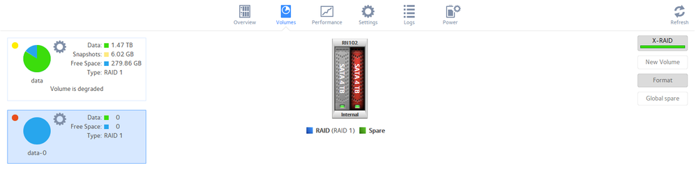

Now I am facing an other problem. I now tried to replace the now pulled disk with one I have used before in that enclosure and the system doen not start to rebuild but indicates that the inactive volumes should be removed. I have tried to diskpart clean in windows for that drive but still the same error. I see the new (reused) disk colored red and some kind of ghost volume appearing when it is insert.
Any ideas how to force the system to accep the old disk. Pushing destroy form the volume menue doesn't have any effect.

When you click on the red (reused) disk, do you see a Format button on the right side of the GUI?
- chris2531Sep 15, 2017Aspirant
Hello,
yes, I see a foramt button. When pressing ist, I have to confirm to format. The system ( at least the GUI) is a few seconds busy but after that nothing changed. THe volume still cannot be used.
