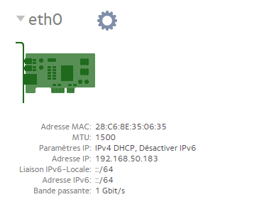

If you're talking about this, it is set right now to 1 Gb/s and not 1 GB/s, could that be the problem ? I cant select it from the settings page of this network tab.
No, this is correct.
- B is Bytes
- b is bits
so 1 gigabit per second.
You can't set this in the NAS, it is negotiated by the NAS and whatever device it is connected to.
