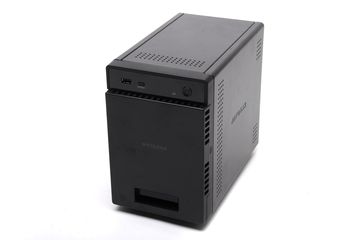

Hello, I just received a RN10400, it had no hdd inside and no power adapter . I buyed a power adapter and I putin a hdd When I connect the power adapter to the rn10400 ..... for couple of secon...
- Dec 25, 2016
I opened the NAS and fixed the display . Everything works now

Thank you for your answer . Of course I didn;t buy it new . I buyed it like it is without trying it or smtg . it was a "what you see is what you get for this price" , and I buyed it .
I have a power adapter ( 12V 7.5Ah ) and as I said power button led is blinking . However power button is not working. no matter how often or long I press it .... it does not turn off the nas . when I am giving power is starts and that's it .

RAIDar seems to "see" the machine .
power led is blinking continuosly , display is not visible / offline .
photo with raidar print screen, please advice what to do next ( except getting a hdd , zero it and drop it inside the machine )
