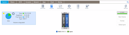

RN312 random volume degraded with no indication why
RN312 (2x 2TB RAID1) now reporting volume degraded, but interface gives no clues as to why. I can see a picture of two drives, one grey, one blue, both with green "leds". Hovering over both shows bot...

dmesg.log (among others) is flooded with unrecoverable read errors on disk 1 (sda, serial # WD-WCC4N7VXZF16)
[Mon Jul 8 11:07:43 2024] do_marvell_9170_recover: ignoring PCI device (8086:3a22) at PCI#0 [Mon Jul 8 11:07:43 2024] ata1.00: exception Emask 0x0 SAct 0x4000 SErr 0x0 action 0x0 [Mon Jul 8 11:07:43 2024] ata1.00: irq_stat 0x40000008 [Mon Jul 8 11:07:43 2024] ata1.00: failed command: READ FPDMA QUEUED [Mon Jul 8 11:07:43 2024] ata1.00: cmd 60/01:70:4f:00:90/00:00:00:00:00/40 tag 14 ncq 512 in res 41/40:00:4f:00:90/00:00:00:00:00/40 Emask 0x409 (media error) [Mon Jul 8 11:07:43 2024] ata1.00: status: { DRDY ERR } [Mon Jul 8 11:07:43 2024] ata1.00: error: { UNC } [Mon Jul 8 11:07:43 2024] ata1.00: configured for UDMA/133 [Mon Jul 8 11:07:43 2024] sd 0:0:0:0: [sda] tag#14 FAILED Result: hostbyte=DID_OK driverbyte=DRIVER_SENSE [Mon Jul 8 11:07:43 2024] sd 0:0:0:0: [sda] tag#14 Sense Key : Medium Error [current] [descriptor] [Mon Jul 8 11:07:43 2024] sd 0:0:0:0: [sda] tag#14 Add. Sense: Unrecovered read error - auto reallocate failed [Mon Jul 8 11:07:43 2024] sd 0:0:0:0: [sda] tag#14 CDB: Read(16) 88 00 00 00 00 00 00 90 00 4f 00 00 00 01 00 00 [Mon Jul 8 11:07:43 2024] blk_update_request: I/O error, dev sda, sector 9437263So you need to replace this disk.
WD no longer makes WD30EFRX. If you want to stick with WD 3 TB, then good options are the WD30EFPX or WD30EFZX (WD Red Plus drives that replace the WD30EFRX). Avoid the WD Red version (WD30EFAX) as this is SMR, and not a good option for RAID.
There's no problem with mixing WD and Seagate in the same array so you can also get the Seagate Ironwolf (ST3000VN006).
If you get a larger drive, you won't get additional space until you replace sdb with one of the same size.
Netgear recommends making sure you have an up-to-date backup before manipulating disks, and I agree. At the moment your array is unprotected, and that will continue until the problem drive is replaced and synced to drive 2.

Regis-IT wrote:
Many thanks StephenB, PM sent.
