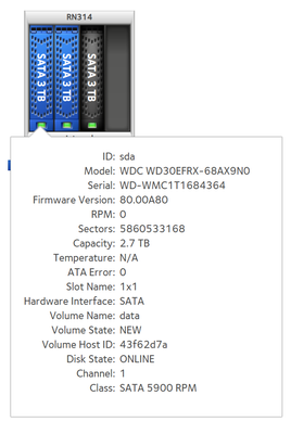

Now disk 1 - that HAD shown 65k ATA errors reports like this
but after a reboot, the dmesg.log file is showing clear issues with ata1 on sda.

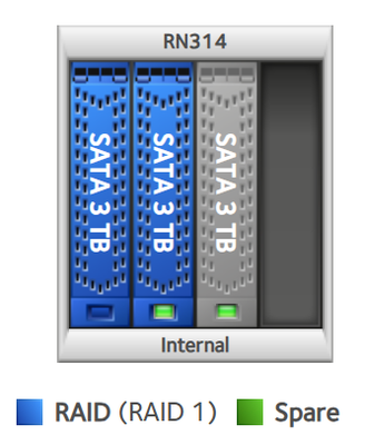

Anyway, I've removed ata4 and formatted ata3 and turned it into a global spare - just doing some additional backups and will remove ata1 and allow ata3 to become part of vol1.
