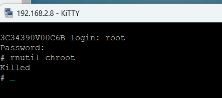

    • curso's avatar
      curso
      Tutor
       Hi Stephen,
      Thanks for your quick reaction.
      I just logged in as root in Tech support mode.
      Launched the rnutil chroot command but I got a "killed" message like you can see
      I guess it failed with the message "flush_space+5a" on the  LCD. I still tried the brtf command in case but it failed.
      # btrfs fi usage //
      ERROR: not a btrfs filesystem: //
      • StephenB's avatar
        StephenB
        Does
        rnutil start_raids
        fail the same way?
