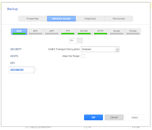

One more setup question though - can you look at your share setting (network access tab, SMB, Advanced), and check the SMB3 transport encryption setting? Make sure it is not set to "required".

re: the 'Guest' thing: Sorry, I saw where you had tried to explain this in earlier posts. It's all a lot to absorb. My apologies.
In share settings/Network Access/Advanced: SMB3 Transport Encryption is set to 'Enabled'.

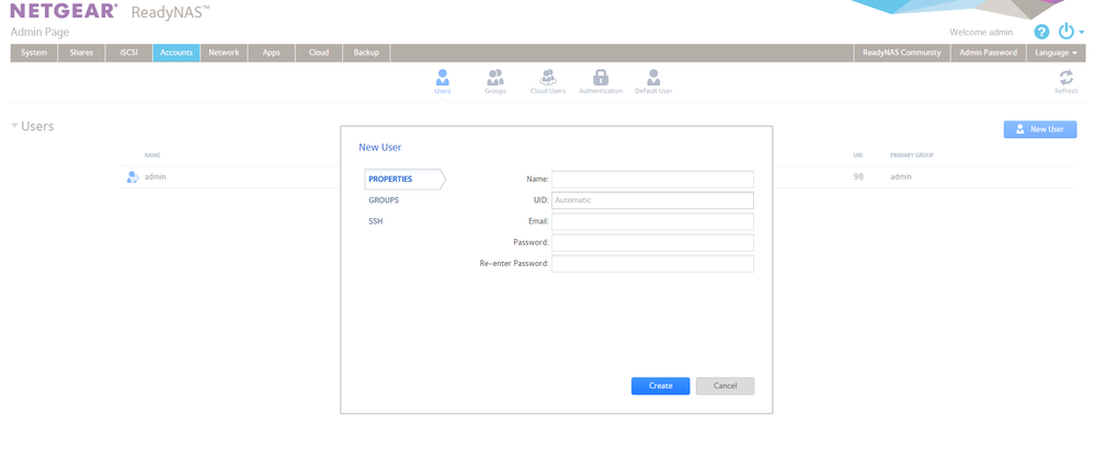

- KenTanker0us1Jan 03, 2018Tutor
re: add New User: In the Accounts tab I tried adding my windows logon as a new user and got an error:
"User name must be unique, cannot be the same as an existing share, cannot start with a number, and cannot be empty."Further, In share settings/File access, the Folder Owner was set as '1003' and the Folder Group was '65534'. I did some reading in the software manual and tried setting them both to 'admin'. This did not give me access, and it doesn't give me the option to set them back to 1003 and 65534 now. The question is: did I break anything? Could you please talk about this area?
"User name must be unique, cannot be the same as an existing share, cannot start with a number, and cannot be empty."Does your windows logon start with a number?
Is there already a share set up with that name?
Perhaps post (or PM me) the windows username.
re: switches: Ok, thanks. I'll pass on them for now. My big concern is access at this point. But thank you all the same for the good info.
re: my windows logon: No, it does not start with a number. None of the shares match it. The logon is a first name last name separated by a space. But the error persists. I looked at the ReadyNAS Frontview for my RNDP6000 (the old NAS) and there are no users added. Does this mean that the only user is admin? I don't even know if this info is helpful.
