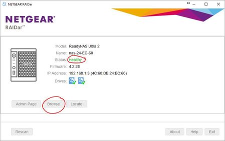

RNDU2000 can not access disks after upgrade.
The message below says that I may not have permision to use this resource:

Thank you for your reply, I get error 59 unexpected network error and error 1244 user not authorized:
