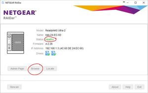

- I-SHApr 20, 2016Aspirant
The data partition gets expended by the NAS if the cloned disks are larger than the source disks:
