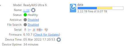

[RNDU6000] How do I recover the space taken up by the 'ghost' snapshots?
Me noticed my NAS is going out of the free space, so I get into the admin panel. Removing all the snapshots of both folders and home folders didn't change anything, actually. How do I free the sp...

SauvageSausage wrote:
How do I free the space, consumed by the non-existing snapshots?
Start by running a balance from the volume settings wheel. That should reclaim the missing space.
root@databox:~# du -sh /data 4.1T /data
root@databox:~# df -H
btrfs fi du -s /data will give more accurate results than du (though it will be very slow).
btrfs fi df /data completes quickly and gives more info than df
Already done!
Thanks for your tip! "btrfs fi du" is in progress; 'df' is:
root@databox:/# btrfs fi df /data Data, single: total=7.20TiB, used=6.95TiB System, DUP: total=32.00MiB, used=992.00KiB Metadata, DUP: total=6.50GiB, used=3.06GiB GlobalReserve, single: total=512.00MiB, used=0.00B
